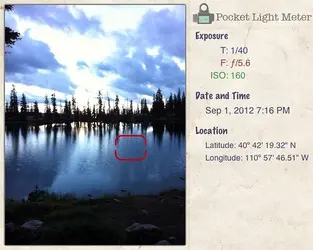

Just got back from my first trip shooting with the camera. I ended up using the Light Meter iPhone app since I didn't want to carry another body 3 miles into the mountains. I wasn't exactly sure what I was doing, so I was wondering if someone could help me out here.
In this shot, would it be better to spot meter on the water, or the sky? Based on how the phone metered the exposure, I liked it when I chose the sky. Does the phone's reaction to the metering parallel the film's reaction as well?
In this shot, I wanted to capture the mist on the water. Was I right in metering on the mist, or should I have metered on the water in the lower right-hand corner?
Are trees off-limits assuming I don't want the image to be super bright? Or should I have gone with the grass here instead?
What kind of film were you using? If you were shooting color slide film, the readings off of the brighter areas would probably be reasonably close to the way an iPhone "meters". And the last "light meter" sample pic, where the tree was metered and the sky blew out terribly...that "scene" is clearly beyond the dynamic range of the iPhone when a dark tone like that is the metering area...as the totally blown-out sky shows. I did not even know there WAS an iPhone light meter app! My comments are based only on looking at these few sample shots. I am "assuming" that the light meter application works reasonably close to the way the iPhone's exposure metering and focusing "Box" system works, meaning that it favors a more-brief, ie "faster" exposure, which is designed to protect the brighter tones from over-exposure, and which is thus more like the way one would want to meter with "color slide film" (or digital!) and not really the the way one would really want to (typically) meter when using color negative film.
Your first two examples show the VAST difference in exposure values in a scene shot/metered only one minute apart. The first shot, with the metering area centered down on the lake water's shaded zone totally"blows out" the brighter sky values...which would be a total disaster if using color slide film. The second example shows the meter "pegging" the highlight values about the way I would expose color slide film, by taking a narrowish angle reflected light reading off of a bright sky tone area, and then shooting at that exposure. Of course, in THAT lighting scenario, that exposure results in a silhouette...buuut....that's what it was, right??? Evening backlight in the mountains...
Yes, the second photo is essentially how it looked in reality, and also how I wanted to expose it. I just wasn't sure if I could "rely" on that reading using Portra 160.
