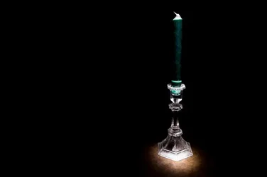

My first painting with light, C&C please

Looks like a simple flashlight and a candlestick.......can you explain your shot ;)
That's exactly what it was :) ... I sat the camera on M with shutter of 10 seconds, f11 and ISO 100. Turned all lights off including the flashlight, when I pressed the shutter button I would turn on the flashlight and pointed it straight down (otherwise I could see the walls and everything else the light was hitting).
Just "paint" with the light, whatever the light hits is what will show up in the photo.
Pretty static, isn't it?
One thing that really bothers me is the landscape orientation. So much black dead space to the left.
I thought this to be a rocket waiting for launching ;)
Vertical framing will accentuate the shape of the thing...
Good work
Yeah I would do a crop to get rid of some of the black space for sure.
Going to mess around some more tonight and will post them using the feedback you guys gave.
