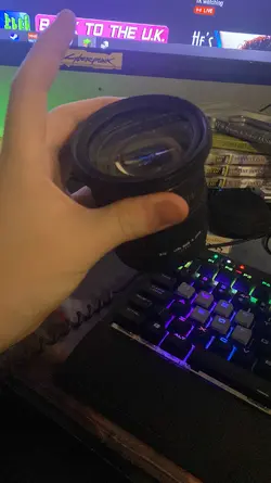

UPDATE:
My stupid ass didn't realise that I had a UV filter on the lens, thank god my dad put one on it when I first got it or I truly would've been buggered!

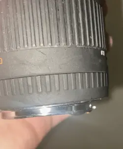

Only issue now is the rail on the lens mount... Is this something that could be replaced/bent back into place?
I've contacted Sigma because I can't find if they still support or have discontinued this lens but either way... I'm really tempted to bend it back into place...

If you do try to bend it back, first remove the mounting plate off the body of the lens ... so as not to damage any other part of the plastic body.
I know you don't want to hear it, but a good shop may even have a spare mount laying around.
And do you still have that rattle with the broken filter removed?
Also second removing the plate from the lens first before attempting to bend it.

The rattle was the glass from the filter, I might ask Wex if they have one but I doubt it because it's an old lens... I've messaged Sigma and I'm still awaiting a response.
Was going to remove the plate before attempting to bend it, Do lens plates tend to be universal? because if so then I'll look into it
I would think any Cannon EF mounting ring should fit, but finding a place to buy one might be difficult. Not many DIY lens parts sources that I know of, kind of a specialized thing.
