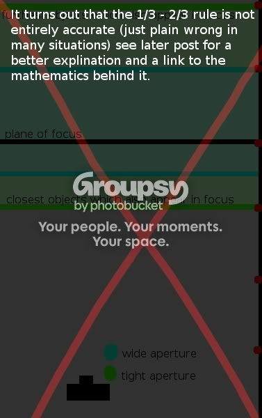

2) Sometimes it's easier to explain graphically, this is how I understand dof:
The blue shaded area is the dof of a larger aperture (say f/4) and the green is for a smaller aperture (say f/8). The red dots on the right are equally spaced for scale.
I know that you understand the basics of small aperture = greater dof, but I included that just for the sake of completeness. ;)

azruial, are you sure that diagram is correct? I've never heard of this 1/3 - 2/3 thing. At least according to the DOFmaster calculator, there's pretty much equal in focus area both in front of and behind the focus plane, and I think that's pretty much the norm. There's some trick lenses out there like the Nikkor 135mm f/2 DC (Defocus Control) that can shift that around forward or back, but that's definitely a very specialized lens.
I have heard that 1/3 - 2/3 from several places, though of course I can't remember where now :lmao:, although the diagram on the dofmaster page seems to indicate similar proportions to my perception...?
Using the calculator on that link, it looks like every variable affects the percent of the dof that is in front of the plane of focus, which means that this is definitely too complicated to understand by looking at the simple ratios and relationships, so.... it's google time!
Okay, here's the answer:
"The DOF beyond the subject is always greater than the DOF in front of the subject. When the subject is at the hyperfocal distance or beyond, the far DOF is infinite; as the subject distance decreases, near:far DOF ratio increases, approaching unity at high magnification. The oft-cited “rule” that 1/3 of the DOF is in front of the subject and 2/3 is beyond is true only when the subject distance is 1/3 the hyperfocal distance." -wikipedia
Thanks Mav for bringing that up, I love going to sleep smarter than I was when I woke up :D.
