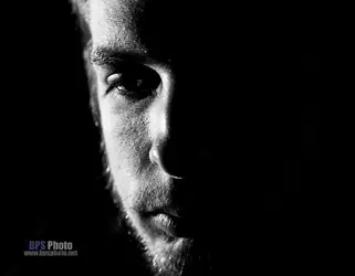

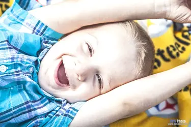

Being a transportation and lanscape photographer, dabbling in portraiture is difficult. I posted in the beginner forum, might as well post here too! Be ruthless! I need to learn!

Some interesting work, but too many for which to provide critique - post no more than four for best response. I will note however that 'up the nose' (#3) is rarely a good look!
too many for me to really comment on individually, but the first two are underexposed, (and/or need fill light).
the next 4 are overexposed. (#3 is the best shot by far, just needs a little tweaking)
the couples shot has some very harsh lighting. bare flash? or pop up flash?
I dont dabble any in the low key/shadowy type of portraits so i wont say much on those.
overall, your crops are all very tight. (except #1) some people like this as a "style", but I am not counted among them.
not really a bad start for beginner portraits. what equipment do you have?
do you have a hot shoe flash?
5D MKII. 2 Yongnuo 560 and one HSS 568EX. All off camera with 622C triggers. I have 4 460's that a friend is borrowing. So everything is off camera.
They are bare flash, but I do have umbrellas for my light stands. Just really don't know when or when not to use them. As for the tight crop, just a style that I'm accustomed too for my abstract stuff. This portraiture sure is a different world, haha. I appreciate the feedback though! I feel like I should give up on shooting portraits and stick with my abstract and landscape stuff!
