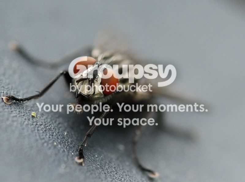

Here's a picture I took several years ago...it's not great but it really shows how shallow some of these lenses can shoot. Notice in front of the fly's feet on the surface...you'll see that really narrow strip of in focus area. That's at f/2.8 so image that f/1.8 is even shallower....

Wow what a cool shot! I will keep experimenting.....maybe I'll get good at this someday.

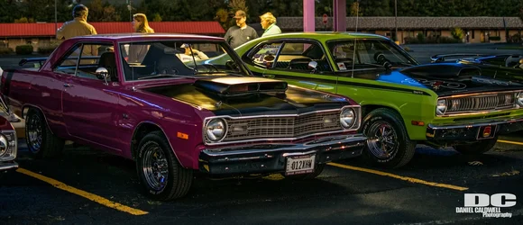

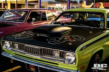

Even at f/1.8 you can usually get more stuff in focus if your are farther away from what you are shooting, you can always crop the photo if needed. when you are close to something that you are focused on you will often get a out of focus or blurry background, so take some test shots at f/1.8 if you are in low light and try different distanced from the subject, if you cant get what you want in focus than change the aperture and any other settings needed to get a proper exposure.
both of these pics were at f/1.8 you can see the first one has allot more in focus because i was farther away, the second on where i was close to the green car you will notice there is allot more out of focus.
