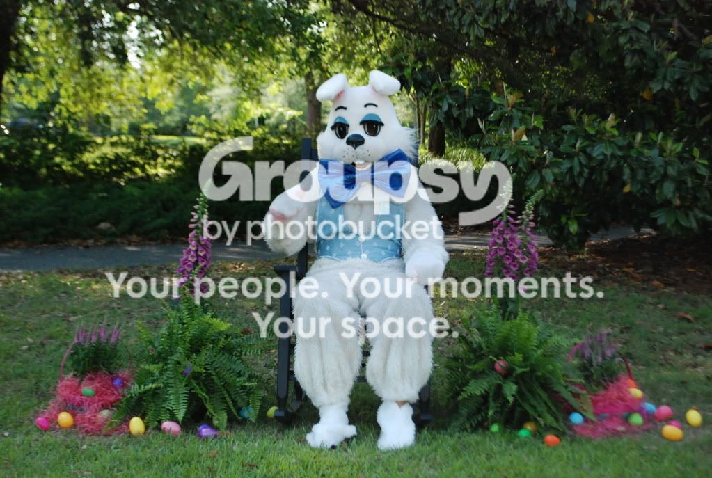

i recently bought a used d80, using a AF-S Nikkor 18-55mm lens, everything on automatic. This shot was taken on a tripod, i am getting blurry corners mostly noticed bottom right or left on a lot of shots, a majority of them actually, using the tripod or handshots. My guess is the d80 body is having problems, but wanted other opinions. i also have a Nikkor 55-200 lens that is having the same problem on this camera. Any help/advise will be greatly appreciated!

So if the camera is set to auto focus, and i am half pressing the shutter button and it is beeping meaning that it is focused, what could be the other causes. I have had another d80 in the past, same shooting style and never had this problem not one time? The only difference in the other d80 i used was the lense was an 18-135mm i believe.
The top left and bottom right are both OOF. Maybe there's an element in the lens that's out of kilter.
Is that something i can check on myself or what? can you point me in the right direction? thanks so much!

Your ISO is also on 1280 for absolutely no reason. You should try turning your shutter speed down, and shooting on f/8 or smaller. If the problem persists, it's probably a lens issue.

I agree the problem is the lens, not the D80.
