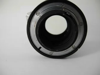

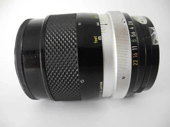

Hi Folks,
I have been seeing a lot of raves about the Nikon 135 mm f2.8 lens on YouTube. It has gotten a lot of praise and attention lately. It is an older (real old) lens and supposed to be one of the best ever made. It is even supposed to work on FX and DX cameras.
I am looking at a particular lens on eBay and just want to know if it will work on my Nikon D610. The seller is not 100% sure and is being honest about it. Can anyone give me the 'go ahead' or 'don't buy it' on this lens? (attaching 2 pics) 135 lens.webp 135a lens.webp
Thank you,
Lonnie
Do not buy this lens unless you can convert it to an AI version which would require a service shop doing it and only if they have the AI ring(which is highly doubtful).
  1. I used to have one of these I do not think I would buy it for use with a camera that does not have the flip up tab, a feature which the Nikon d610 does not have. This is a so-called pre AI model, And is not that particularly good. I would look for a 135 mm lens from the AI or ai-s era, either in F / 2.8 or in F / 3.5. I believe this lens is what some people call a fat Barrel lens, which means that the aperture ring is somewhat fat in comparison to later lenses, and can cause problems with the AI sensing lever and even more seriously with the maximum aperture sensing pin which is located at around 6 to 7 on the lens mount, as I recall. it has been over 20 years since I got rid of this lens but it was not a particularly good 135, just average. The Stellar reputation for the 135 m m f / 2.8 comes from the later AIS version and one particular YouTube "Angry photographer"guy

@Lonnie1212, It is very specifically the multi-coated versions which are the QC and 'K' designations of the older pre-Ai 135/2.8, serial nos: 380 xxx - 464 xxx. And they would have to be converted to Ai (Nikon's new Aperture indexing system) before you even mount them on a D610, (there is a possibility of damage should you try to mount non-Ai lenses on the D610).
It is a nice lens and worth trying out if you get one at a reasonable price. Actually quite good performance across the board, but you need the multi coated versions as the single coated ones tended to flare. The AP is just re-regurgitating opinions already around the internet but in his own confrontational style. It's a good lens and a nice object to own. But it will not transform your photography or turn you into an instant douche-bag should you choose to give it a miss.
I was lucky a few years ago and picked up a mint copy, (really mint!), and also managed to source one of the last factory Ai kits for it. It's still mint and lives on the shelf at present.
