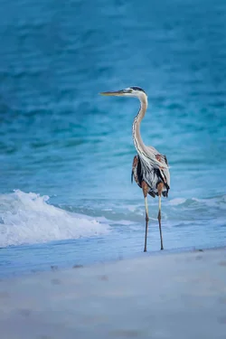

Hi all,

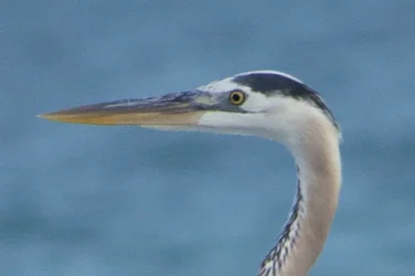

I have a T3i with the Canon EF-S 55-250mm IS II. My results look decent as a small image, but when I zoom to 100% things are just not very sharp. Consider this picture, taken at f5.6, 1/200, 250mm, ISO 400. I used only the center AF point, which was on the bird. The picture looks reasonable (bird.jpg), but if I zoom in (head.jpg) you can see what I mean (I shot in RAW and exported these jpgs from Lightroom).
Should I expect better results than this with this gear? Is there something I am doing wrong to cause this?
Thanks!
David
The $300 Canon EF-S 55-250mm IS II is an entry-level consumer grade lens that will not deliver images a sharp as Canon's pro grade EF 70-200 mm f/2.8L IS II USM lens that costs $2500.
Some things you can do using image editing software is increase the mid-tone contrast, which adds some edged definition or clarity.
You can also sharpen the image. There are several ways to sharpen a photo and the subject is involved enough to be a book length subject.
The guys that wrote the software that is Adobe Camera Raw's Sharpening panel did just that - they wrote a book -

How far were you from the Heron ? Distance can be a major factor. Handholding technique is a big factor too. To rule that out you can try a mono or tri pod. Front focus or back focus can cause issue too.
Well, first off, it's a good "picture"! I see two things: a bit of sensor noise, no doubt due to the ISO 400 setting. And also, a somewhat less-than-state-of-the-art lens resolving ability. But also--keep in mind, on MANy days, there is a huge amount of airborne particulate...water...that moves along over ocean waves, four or five feet above the surface of the ocean. Over longer distances, like even 100 feet or so, that airborne water reallllllly cuts down on the ability of even the highest-grade lens to show fine details. Also, if your focus was off by even eight inches, it would show up as lessened detail, yet still "acceptable" when seen small.
I was at the beach last Friday, and OMG...there was a LOT of airborne mist, and on 400 yard shots up the beach, the amount of airborne water was KILLING my sharpness! ANyway, I like this photo. I think it would look sharper if you really "jacked" the clarity, as KmH mentioned...that would make it look "sharper", by a bit. Keep in mind, the light itself is flat, and low-contrast...soft...delicate..muted...and so the lens is showing that. The actual, on-the-beach light was FLAT. Flat as a pancake. And so the photo reflects that accurately. I would rotate the shot a tiny bit CCW, and level the horizon and maybe darken the exposure and boost the White Balance temp higher and shoot for a sort of "evening near Miami" look or whatever city this is, and call it a good frame!

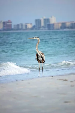

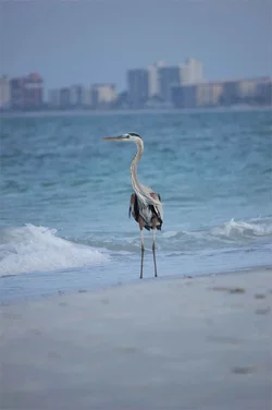

Regarding the first shot, it looks a bit washed out to me. In the edit I am posting, all I really did was tweak the levels and boost the contrast a bit. Lee
original
edit
DLeeT's boost of the contrast and his adjustment of the levels really boosts the impression of "sharpness". Sharpness is caused by a number of things, not just one, single thing.

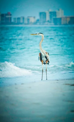

You could even take this image a whole 'nother direction, like this.
New here and just browsing the forumns looking for a photo to edit... Hope you don't mind me working on this one for you.
Replaced the city scape as well as I kind of like it without it. Sharpened it up, adjusted the blues, some radial shading and a few other modifications.
Hope you like it.
And a super edit by Vince00--on his VERY FIRST post on TPF!!!! Had to give him a "like" for that!
