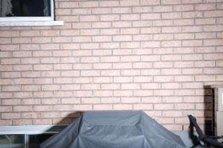

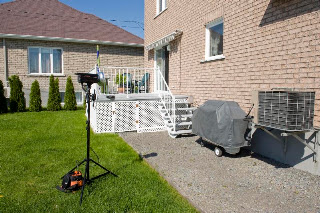

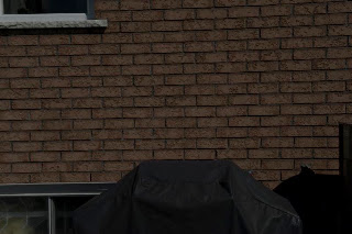

A single light source like a Photogenic 2500DR (1,000 W/s) can overpower mid day sun quite easily. The "Sunny 16" rule says that if you are outside on a bright day at noon on a cloudless day, set the aperture to F/16 and you are good. With a single light, like I am talking about, I can set my camera to ISO 100, F/22 and from 12-14 feet away still lightly overexpose a good sized area:
Before:
After:
The setup:
