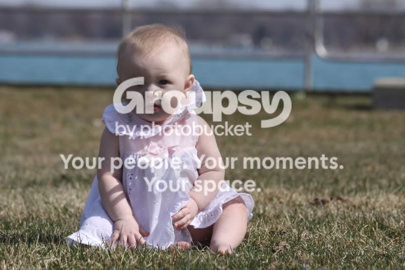

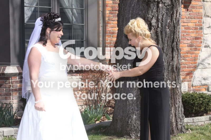

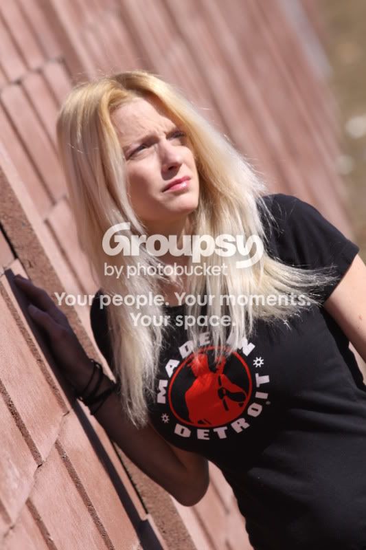

Here are some of my troubled images due to overly bright circumstances.
The dress is washed out.
Shadows on her face and once again the over bearing natural light kind of ruins the image.
Shadows on her face again, this one isnt that bad. But I know it could have been much better or more professional looking.
I'm with Felix 222. You use a diffuser and you use strobed light so you can control the ambient sunlight.
That means you have to use a shutter speed faster than the normal flash sync speed. Nikon calls it FP mode and I think Canon calls it HSS.
At any rate, the advantage gained by using flash is that you can use aperture to control subject exposure, while using shutter speed to control background exposure and keep the background darker than your subject.
Light advances and dark recedes. You don't want a subject that is darker than the background. You can just use a reflector for fill, but would still have a subject darker than the background.
Great example from Felix.
Some of the best light you can get, is to hold up a diffusion panel between your subject and the sun. Have you seen those 5-in-1 reflectors? The 5th one is a diffusion panel as seen in that photo. The white reflector surface is similar, just not as opaque.
If you can't use a diffusion panel, then just using a reflector to bounce some light onto the shadowy side, can make a huge difference.
Either way, the key is to expose for the important parts. If that means exposing for the subject, and letting the background be blown out, then so be it. Sometimes that means letting the dress be a bit too bright, rather than having their face too dark...but that's not ideal.
As mentioned, when using flash, you can underexpose the ambient light and then use flash to put light where you want it.
