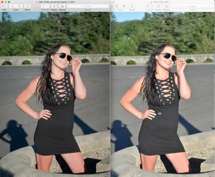

Sunburn and hard, unmodified summeretime lighting in the Columbia River Gorge Natural Scenic Area a coupelk weekends ago...
Thanks, @Derrel. In your pic., I see harder shadow under the model's chin. Plus, shadows around her thigh are also distracting. Will you make them a smooth transition in Post-Production?
And the background in your pic looks underexposed as against the pic. I shared. How do you think that can be achieved?
Derrel can speak for himself but I don't see the background as underexposed in his photo. He was most likely at a pretty fast shutter speed by just looking at this one. Besides if you expose the image anymore, you will loose detail in the forehead and cheeks of the model.
The background was amply well-exposed at 1/250 at f/7.1 in July afternoon sunlight. But the way I processed it, I tried to emphasize the shadows, not artifically lighten them and make them go away...the shadows, being dark, make her legs stand out....light advances, dark recedes. You see, the shadows on the ground, the shadow of her torso and arms, and also the shadow from the historic, 1920's-era lamp poles at Vista House, are both parts of this photo's compositional idea. I'm actually using the dense shadows as a compositional element...so no, I am not going to "lift" them away.
What you are seeing as under-exposure of the backdrop is a result of the processing I did on the .NEF file. Here's the original SOOC camera-processed image shown on the right, compared to the Lightroom processed proof file, on the left. As you can see I have deliberately made the shadows darker, and more-dense in post.Screen Shot 2017-07-21 at 6.29.17 PM.webp
Using a high, hard, main light source is a classic way to photograph people outdoors, or indoors. The high, hard shadows make the face "pop!" It's an older style of using natural, or studio lighting, using shadows to provide clues to the shape and depth and texture of things... Hence, no, I am not going to lighten the shadows one bit. I do not want this "light from everywhere, light from nowhere" look that so many young people seem happy with. Too much fake fill light looks unappealing to me, but I am a man in my mid-50's so...
