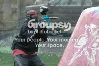

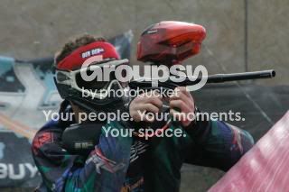

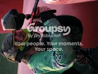

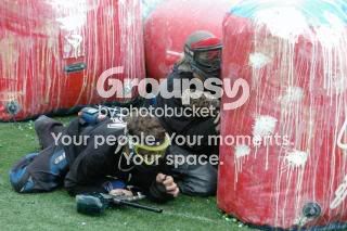

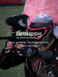

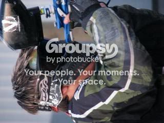

So, one of my hobbies is taking in game paintball photos. Let me know what you think of these, and what I could do better. While it's hard to think about photographic technique while being shot at, I try. ;)

Technically these images are adequate; they'd be improved in some cases with a fil flash, esp, #s 1 & 2. What strikes me most about the majority of them (1, 2, 3, 4, 6) however is that they look like nothing so much as paintball mugshots. That is a close up of the head and shoulders of the person; there's no sense of where they are or really what they're doing.
In 5 and 7 you've opened up a little bit, but still don't really see much. You're using an appropriate versatile lens, but sticking to close to the narrow end. Open up more. A LOT more. Remember, you can always crop in post.

If you look at 1,2 and 3, you'll see that you've cropped the gun, and the limbs; try to at least get a complete bust shot, and go for a head on, or at most 3/4 profile. People's backs and sides aren't especially interesting.

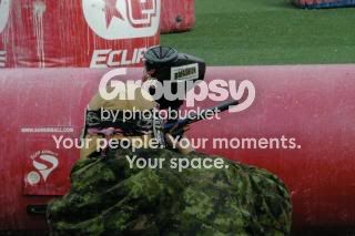

Here's one from today. The weather kind of sucked.
