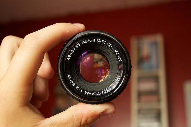

Thank you for the replies, I have the lenses now and they are both K mount. Can somebody please explain what AF confirm is? It seems to be an option on some of the adaptors. The lenses specifically are the Pentax-M 50mm 2.0 and a Centon 70-210mm 4.0-5.6.

Thanks! After trying a couple of test shots just holding it up I'm glad I went for the AF confirm, it's real hard to know your focussed at f2. I'll be sure to put up some shots when I get the adaptor in the post :)
Tells you something about quality when the 50mm alone is far heavier than my 18-55 kit lens.

Thanks for the info, guess I'll stick to the Pentax lenses, they make a 50 1.4 that seems to pop up every now and then for around £80, with the AF confirm it's actually fairly fast to accurately focus so I'm not so fussed about the Canon EF 1.4 anymore. On another note, I just cleaned out some of the fungus in the Pentax 50, luckily it wasn't deep and came off easily, very easy to get to it too.
