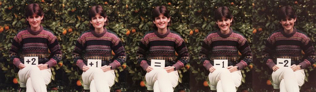

Depending on what you are photographing, it may be worthwhile getting a hand held meter (maybe borrow one) to see that everything is working as it should. However, most print film is fairly tolerant, so it won´t really matter if you are a stop out, but just remember that over-exposing color negative film is safer than under-exposing.
Here´s an example...note the difference in the shadows...at 1 and 2 stops under the black is actually a washed-out dark grey only, whereas in the other pictures there is virtually no difference!
