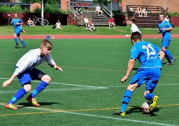

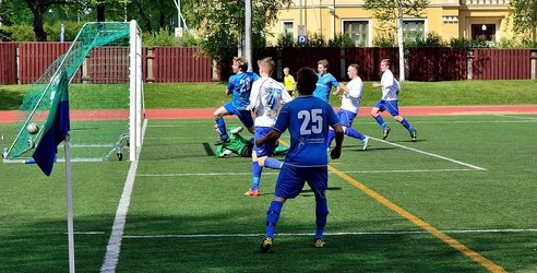

Hi there.
I photographed a football match on Saturday and had some issued freezing the action. I was using continuous focus mode and in shutter priority. Still I had these issues freezing the action maybe could there have been a focus issue? I was using a shutter speed of over 1/1000 sec most the time and mainly 1/1600 ISO 1000 aperture f/8 - f/11 the sun was behind me and I was using Nikon d5100 with the Tamron 70 - 300mm VC USD. I had the VC turned on could this have been the issue shooting so fast shutter speed with it ?
I went to the game and hoped that I would be using Shutter speed at 1/800 ISO 200-400 and F/8 ish but on preview looked a bit too blurred. I dont have any of the bad images as just dumped them but have kept 3 images that maybe you could see what I could have changed about them?
Thank you.

If you're using a shutter speed of 1/1600th of a second, it is highly unlikely that you're seeing any motion blur. That should be plenty fast enough to freeze action. I think it is much more likely that you're just missing father focus.

Just one week before this I went to the world speedway championship and was using shutter speed 1/800 ISO 800 f4 and was freezing the action perfectly no motion blur no focus mishaps but this football game I took about 500 images and only 46 were OK after sorting further only 8 were actually OK.
Was using single point continuous same as I used for motor sport and small birds and have never had issues, I thought the AF could have been a issue but when I checked back on View NX the focus points were on the heads of player I was after if not on heads if too far away it was on the player at least.

I don't see movement blur or shutter blur; I think it might be the focus. In the last one #25 looks more in focus than the other players, and I noticed the flag to the left looks more in focus. You might need to get some practice shots and see what settings for your camera will get a large enough area of the field all in focus (to get a group of players all in focus).

From a technical standpoint these all look OK to me. There is no motion blur that I see.
I am not sure why on earth you are running ISO 1000 at a mid day outdoor shoot. You should be able to pull plenty enough of a shutter speed and aperture setting to keep an ISO easily under something like 400. What I do see is some missed focusing issues. Try to keep the focus point on a head. If you use something like a chest, you'll likely catch a swaying arm. And I see that in some of these shots, looks like the focus point is somewhere between the players.
From a getting a better picture standpoint you can do a few things. First thing I noticed is how high the camera seems to be. I'm not sure if you are just that much taller than the players, or if you were in the bleachers, but getting down lower would have helped all of these shots. Second, would be to pick out a single subject, and not worry about shooting such a small aperture. Third, you need much better facial contact. Soccer isn't a very action filled sport, so there isn't a real reason any of these crops need to be so wide. Get good facial contact, zoom in a little tighter, and show the actual emotion of the players and the game more.

That was maybe a bad image to have enlarged as someone else stole the focus and it became a little bit lost, it was only first time shooting football so will keep practicing, wanted to get some tips and got some great ones to try next time. It felt very different to motor sports.
