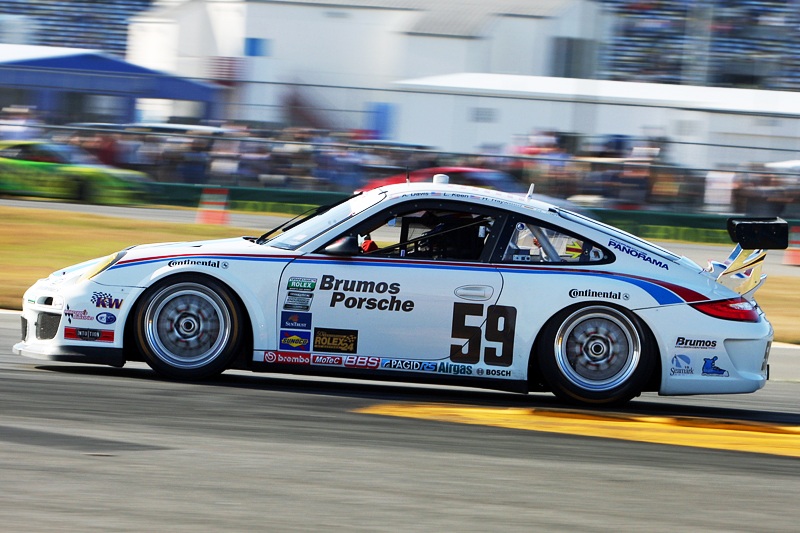

But that's okay. You want to pan. Panning along with the car, you'll want a high shutter speed, but not so high that you freeze the wheel motion:

Steve5D, thank for posting up some great shots there!!

And thanks for the comment about my shots!
