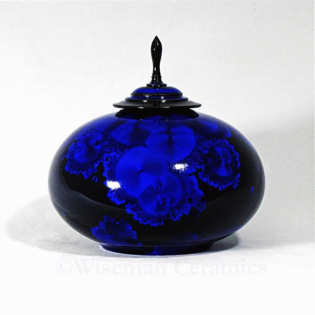

Hello!
First off -NOT a photographer... I don't even kid myself about that.
I'm actually schooled as a studio artist w/ an emphasis in ceramic chemistry.
A few of the glazes I produce are semi-matte to matte, but most are gloss (e.g. reflective!)... and some of these are glossy and dark.
The best example is the glaze below with cobalt blue crystals floating on a jet-black background:
The lidded jar image above came out OK, except for that wavy reflection underneath, and I did have to do digital editing to correct the color. The next one however, is crap, IMHO:
You can pretty much shave in the reflection these give off, & even career photographers say it's like taking a picture of a blank TV screen from 3 ft. away (I actually got a good laugh out of that analogy).
I've tried non-diffused focused light, but since my space is limited, they leave large hot spots due to the distance their set at.
I also use a large 5X5X5ft diffusing tent (smaller tents & cubes just left huge "window pane reflections"). The larger tent does a better job with the less reflective glazes, but makes the gloss pieces look like their out of focus or coated with hairspray.:grumpy:
