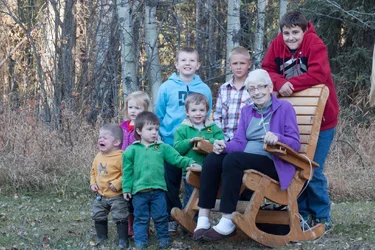

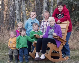

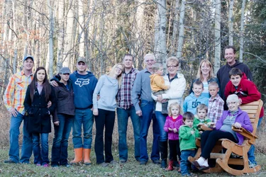

Thank you guys for the quick replies. I only shoot RAW. Looking through the pictures again I did find a few were under exposed but most were right where they should be. I'm not sure how to post pictures with the exif data, I am kind of new to forums and posting pictures actually. I will post a few pictures from them group I just took and hope the needed info is there. If anyone could offer any advice to try and make them a bit smoother if would be greatly appreciated. I have photoshop elements, cs6 and lightroom 5. I did toy with some of them already to try and make them sharper.
picture number 1 was: ISO 500 f/11 1/60
number 2: same
number 3: ISO 400 the rest is the same
I have others that were ISO 100 and have the same noisy look. They just aren't sharp.

I wouldn't shoot at f 11, that's probably not the sweet spot of your lens.
1/60 is really at the lower edge for shooting hand held
You are in pretty deep shade, it looks like, very blue and no directional light.
What you want is open shade where there is no direct sun but where there are shadows, that's what makes things look sharp.
You would be better shooting at f 8, 1/150.
These need mostly to be color corrected and sharpened and they'll look a lot better.
Then warm these up considerably
Thanks The_Traveler that looks a million times better. It was absolutely more shade then I would have like, we were behind the house. My only other option was dappled light through the trees. The area had some directional light when I set up but it went behind the house fairly quick. My camera was on a tripod so that's why I wasn't really concerned about shutter speed but I can see now f/11 was a bit too low. I never shot a big group before so I went with halfway through the range to avoid blurring the people on the outsides. This is all part of learning but I have honestly never been so disappointed. Can I ask what steps you took to make the faces that smooth?

I'm going to split hairs for a second, solely because it might help the OP. The base ISO - which is fixed, and does not change - of the sensor is, say, ISO 100. Shooting at ISO 500 would have been just fine, had they recognized that they're effectively trading highlight detail for faster exposure times and compensating accordingly, deciding what to keep and what to throw away. Just as an example: in a situation like group portraiture, one might be "keeping" the ability to freeze faces (by using a high ISO and fast shutter speed at a given f-stop), but "throwing away" detail to noise. It's all trade-offs, and frankly, I think the OP did a wonderful job. These are really not bad at all!
