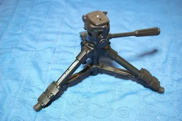

Hey guys,
I want some tripod only for the stars, I'm on budget and... here's my 2 choices.
Velbon CX-460 mini and Sony VCT - R100, which one will you prefer and why?
Just looking for something low and stable, the height doesn't matter.
Any advises are very welcome!
Low and stable? Is that all?
How about a 24" x 24" piece of plywood with a 1/4" or 3/8" bolt & nut through the center of it for a ball head?
I'm not kidding.
Sparky's idea is the cheapest, stabelest you're going to get. Cheap tripods are generally NOT suitable for astrophotography since it tends to involve long exposures and even a breath of wind can shift those, and ruin minutes or hours of work.

And how do you thinks those 2 tripods won't do the job? If it's hopeless I'll try the plan above, it looks solid as hell, hah...
They're made with lots of cheap, flimsy plastic, thin legs... 30 years of experience tells me that either of those is likely to blow over in a moderate wind with nothing on them, never mind a camera & lens.

If you absolutely must do this at least get a tripod that will allow the legs to fold outward. Fold them back as far as possible, get the tripod as close to the ground as possible, and put sandbags on the legs to stabilize things. It's not going to work as well as a good tripod but you get what you pay for when it comes to tripods.
Then the Velbon would be a good choice $958cdfd737b43841a83b9678095889a7.webp
Not in my opinion. It is too small. Put a camera on top and the slightest wind is going to blow it over. My Manfrotto tripod has legs that are about 44" long and it will go down to 3-1/2" off the ground with the legs spread. It cannot blow over.
