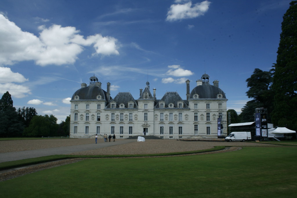

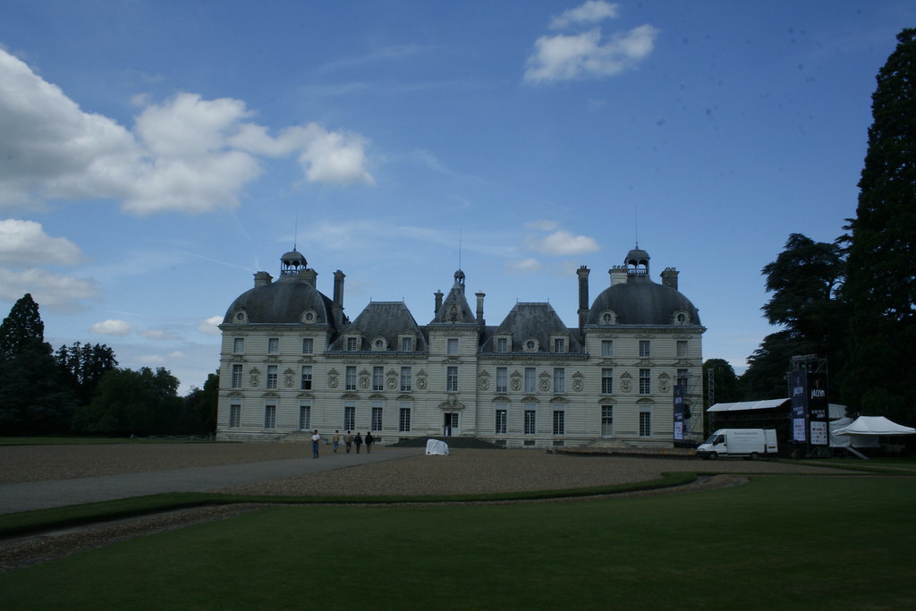

Here is the same scene with and without Pol effects:
Without
With:
I made these to prove to my friends that this 50-dollar-piece-of-glace is worth it!
