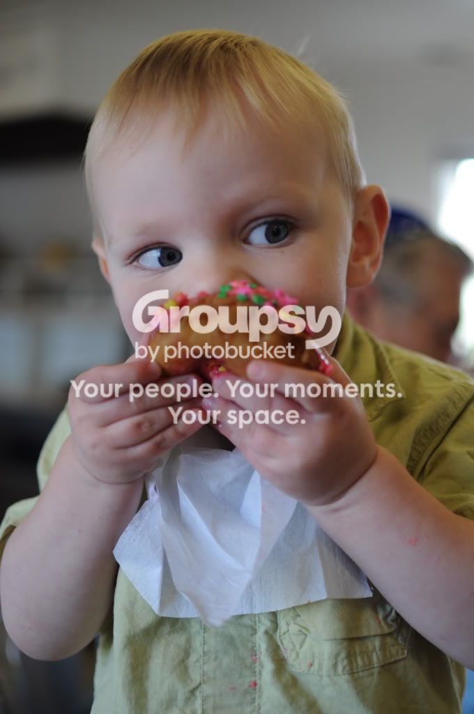

Without flash, indoors.:

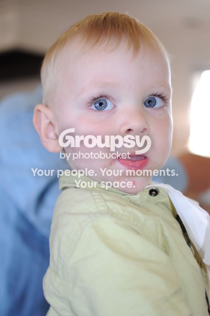

With flash, indoors. I see the difference, but to my untrained eye he looks so pale. Is it just because he is pale? I just really don't want to white him out, that's why I'm so intimidated by the flash.
With flash, indoors, with my back to the sun and windows (I think this gave the best lighting, even though there's a pole coming out of his head.:er:)

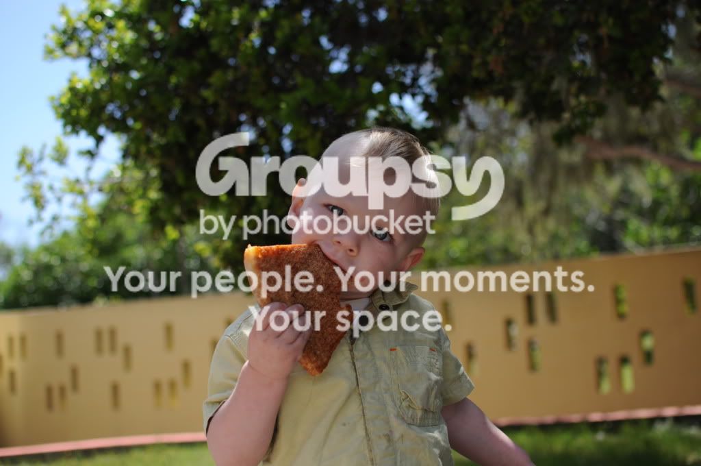

Without flash, outdoors under a tree... Now I feel like some people would say there are shadows on his face and it's not very well exposed. I see that... but I tried to shoot on manual, and couldn't get the meter to the center, it was completely to the "-" side no matter what I did. This is probably lack of knowledge on my part of how to use my camera, so I'm looking it up after I post this.

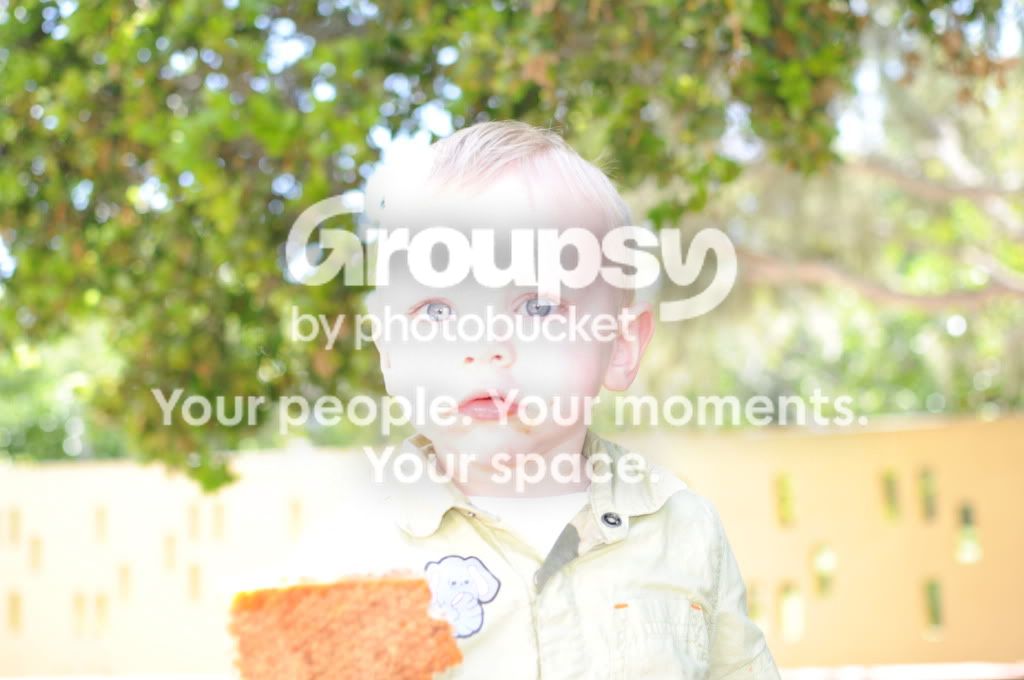

With flash, outdoors under the tree... So thinking I'd get rid of the shadowy splotches, I tried flash. Didn't turn out so well.
So outside, I tried as many different settings as I could while chasing my son around, like trying to adjust the flash compensation and the exposure compensation, but they all turned out like the one above.

My grandson is fair with blond hair, so I have experienced the problems you are having with shapshots. I really liked the shot of him at the counter, and did a quick edit - adjusted the gamma .77, adjusted the green channel -7 and sharpened it a little. I "assumed" that the shirt was a neutral khaki rather than a grenish khaki, and that his coloring has some pink undertones.

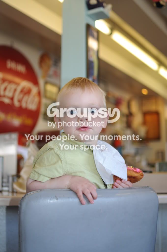

You have come the closest to perfection in the third shot of your little trooper, where he's in the gray-backed soda fountain chair, with that big, wonderful old round Coca~Cola sign on the wall in the background: you swung the camera around to do a tall composition (bonus points!!), and the camera's shutter speed and aperture are both pretty appropriate for the background ambient light level. His eyes have very large catchlights in them, which adds a lot of eye sparkle. The flash unit's output is pretty close to the exposure level of the f/stop/ISO/shutter triangle--see how the shadow the flash casts is not inky-black, but has detail in the shadows?? That is fill-flash. Very nicely balanced exposure, with the flash output, the ISO, the lens f/stop, and the shutter speed ALL being in perfect balance from the close, flash-lighted kiddo, right to the background wall. Very nice.
The exact opposite is the last shot---the entire frame is over-exposed. That can happen if the ISO is too high or the shutter speed is too slow, or the lens's f/stop is set to a wide aperture, like say f/4.5 outdoors in bright weather. A combination of any, or all, or one, or two, or three of those factors can blow out an outdoor fill-flash exposure, and as you can see, the last shot is a disaster, whereas the one I liked so much can be adjusted quite a bit, as other people show so well with their retouching/adjustment efforts.
The thing about shooting fill-flash in Aperture Priority or Programmed AUTO modes is that the camera will often give you very long, slow shutter speeds, which will lead to blurry subjects. Indoors, in dim light, the camera might dish up f/8 at 1/4 second with flash, and you'll have a good chance of a blurry background due to the slow speed, and then a crisp, frozen image when the flash goes off and makes something like a 1/2,000 second, ultra-quick flash pop. Shooting flash in Aperture Priority (what Canon and others call Av or Aperture Value) is risky...the shutter speed will tend to yo-yo all over the place, which can lead to disaster....it's like going 5 MPH down the freeway...you need to be going FAST on the freeway!!! 55 to 70, you know??That is the rule for outdoor fill-flash when it's a sunny season like spring and summer...the shutter speed needs to be fast and the f/stop needs to be a small-diameter opening like f/11 or even f/16 in bright light. You need to be in control when shooting flash + daylight fill-in work, and Manual mode makes staying in complete control easy,with no 'surprises' from the camera's automation.
In bright sunlight, the lowest ISO your camera can go, usually ISO 100, is good for sunlight flash; an exposure of 1/200 second and f/11, will be average in sunny months; on the shot that is over-exposed, if the ISO had been at 100, the shutter at 1/200 to 1/250, and the lens at f/11 or so, the fill-flash would have been controlled by the camera on the close-up BOY, and the ISO, shutter speed, and lens f/stop would have controlled the exposure on the BACKGROUND...but, that didn't happen outdoors, did it? It all matched up at the soda fountain, but not out in the yard...
Outdoors, using a fast shutter speed, like 1/200 second is a good idea with most cameras. When you need help with flash, always state your camera model and flash, since there is a huge amount of difference in how some of the systems work; some cameras are "dumber" than others, when flash is used, or when doing fill-flash some cameras will allow much faster flash shutter speeds: like the Nikon D40 for example, it will shoot flash at up to 1/500 with Nikon flash guns.

For the outdoor pictures
The first image was 1/1600 @ 2.8, ISO 200 (NX2 actually reports it as "0.7EV under 200").
The second image was 1/200 @ 2.8, ISO 200 (same thing reported by NX2 as above.
So, what happened? Your camera was in aperture priority, so the camera stayed set at the aperture of 2.8 and dropped the shutter speed since the flash was popped up. When the scene is so bright (1/1600 @ 2.8 is pretty bright) to use fill flash with the on-board it will help to keep the shutter speed around 1/200 and adjust the aperture to keep from getting too bright.
I know you read my article, and I didn't go in to this detail in my article, I may have to add to it! If you had a speedlight and the camera can be set to sync at much higher shutter speeds using High Speed FP Sync which is bursts of flash, but I won't go down that trail right now.
So what would have worked here?
1. Switch to manual and set the shutter speed to 1/200 and the aperture to somewhere around f/8 . That would get you near the same exposure as 1/1600 @ 2.8. Then use your flash compensation to adjust the on-board flash until you get the look you want. Maybe go to F/11 if the image was still getting overexposed.
2. You could set shutter speed to 1/200 (check manual for flash sync speed, I think the D5000 is 1/200) in shutter priority, and let the camera choose the aperture, keeping the ISO around 200 (100 if your camera allows). Adjusting flash compensation as needed.
I really need to add a section about sync speed on my article you read. I kind of feel bad about it actually. It's something I failed to mention (I don't notice the issue as much since most of the time I use my speedlight or not running into this situation with my on-board flash).
You could also try 1/1600 @ 2.8 in manual, with the flash, and adjust the shutters speed and flash compensation to see if you could have lifted the shadows with fill. I'm just not sure the on-board would have done much at those high shutter speeds.
