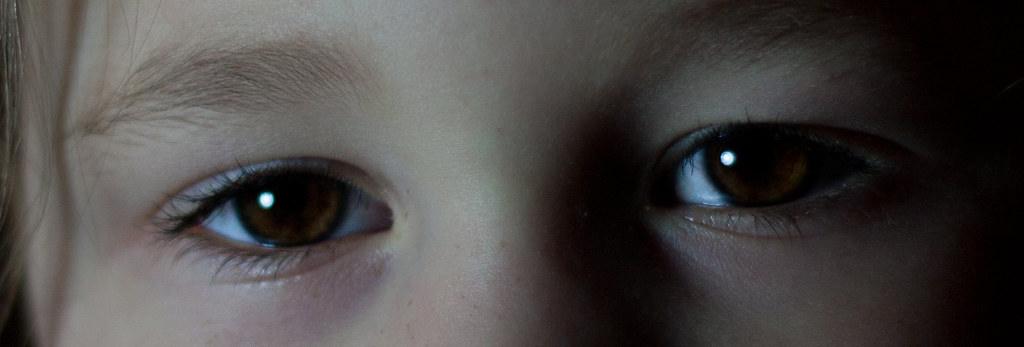

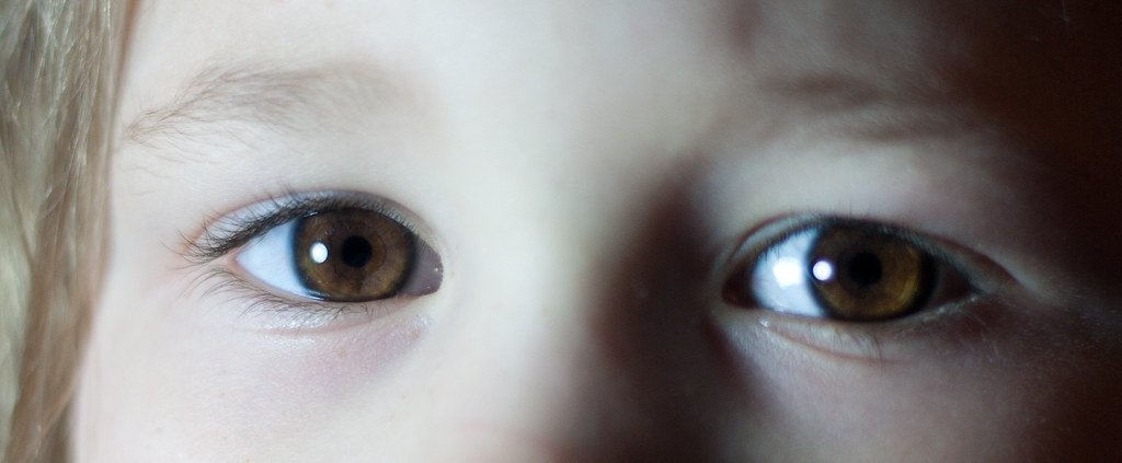

Not sure what you will want to CC on this. I wasn't going for composition by any means. I was using just a plain clamp light (desk lamp type thing from walmart) with a daylight rated CFL bulb camera left and level with my daughter's face and a little bit in front of her. I am using back button focus (first time! I love it!) and I used exposure compensation at +0.6 on the second one. The first one is NOT using EC.
These are SOOC other than having the eyes brightened a little in post :)
1. ISO 200, f/1.8, 1/160, spot metering (could I have used a different metering option? Spot metering stays in the center of the frame, not the focal point). I had the focal point set to the far right which would have been on her left eye (camera right).
2. ISO 400, f/1.8, 1/100, spot metering. Everything else is the same. I don't understand why the shutter speed is lower on this when I upped the ISO... I had to up the ISO to get a shutter speed that I could handhold because I don't have my tripod right next to me... This is also the one that I used EC on... Duh, that's why the shutter speed is slower because I was using EC to get the image brighter so the shutter speed needs to be slower... Grr! I think it looks like her left eye (camera right) in this one is OOF which I am going to assume is a DOF thing and not a camera shake thing because her right eye (camera left) looks pretty sharp to me...
I cropped for just the eyes because with the wide aperture and how close she was to me, her nose wasn't in focus and it looked like crap and it was distracting from what I'm trying to accomplish. I want to make sure I'm nailing focus on the eyes...
1.8 was too large to get both of her eyes in focus. You only focused on one of the eyes in each picture.
Grrrr. Maybe I'll set up ocf when we get back home from ballet...
Because the DOF was to way shallow and both eyes were not the same distance from the image sensor.

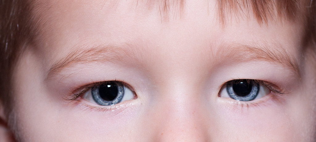

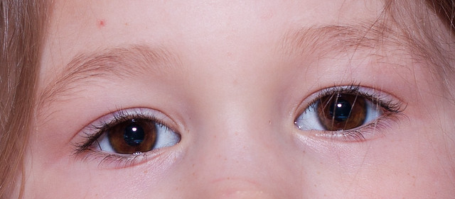

Okay, so here's a couple more. Just snapped them at dinner. Again cropped into the eyes because the faces were distracting for one reason or another...
Spot metering, shot in full manual, 1/100, f/5, iso 100 on the brown eyes, iso 200 on the blue eyes. Again, these are sooc except for brightening the color of the eyes. Did not touch sharpness at all. Still using back button focus. I lit both of these using my vivitar 285 at full power. The histogram did show some clipping on the dark side, but also had the "small hills" in the middle which (if I remember correctly) meant that the midtones were exposed properly. In this case, I believe that would be their faces, right? If I am still misunderstanding SOMETHING, please let me know. I'm trying to get this and I'm trying to remember everything that everyone is telling me.
