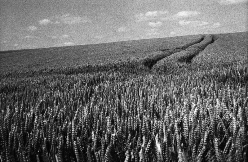

Is this the sort of thing you are after ?
26 years out of date Tri-x over agitated in Rodinal, if you over agitate with Rodinal it gives you some good grain
Yeah, this is awesome. Is over-agitation a general grain-inducing technique?
Maybe not that general,(it works with 25 years old TriX), usually is used to increase contrast (which works with very old TriX also well), but developing in higher temperature (24-25 C) will increase the grain on regular bases and developers with low quantity of sodium sulfite will help to (thus paper developers). You just might try everything at once.
