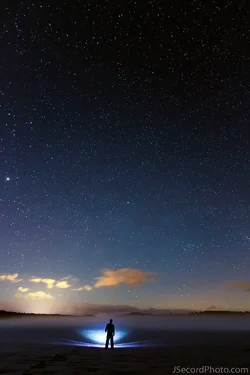

Just curious.. does anyone know why in most of milky way photos, there is someone in foreground holding a flashlight in to the sky? I understand about having a foreground to give depth and make it more interesting but why a person with flashlight?? There are so many of the same set up.
Also, are they two exposures? one for the person with flashligh and one for the milky way?

Majeed with http://www.thephotoforum.com/forum/landscape-cityscape/361535-me-tree.html, yup, he's lighting the way...

There are some more as well, but Majeed's the only one with any kind of light. So I'm curious why you thought that "in most of milky way photos, there is someone in foreground holding a flashlight to the sky?". In Majeed's case, it was two exposures, as he explained in the post. Other... not.
It's not a bad idea to create a link between the sky above, and the the foreground (be it a person or some other object). Whether it falls into "cliché" territory depends on how well (or poorly) the two are joined in an apparently "natural" way.

Most of the images I see of the Milky Way don't have a person in them... but often the foreground object will have some light-painting (i.e. the photographer may have used a flashlight to illuminate the foreground object to help it stand out and prevent it from just being lost in the darkness.).
In some of the Milky Way shots that I have seen had the flash light.. But it's OK if it's just for creative reasons.. I thought there was some technical reason behind it ;)
