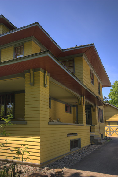

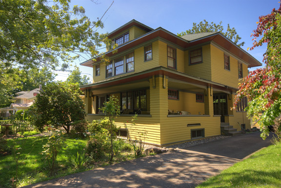

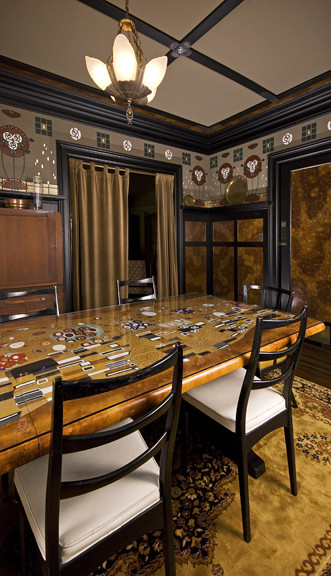

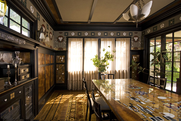

And here are a few of my pics from one of my first shoots, if anyone feels like commenting or critiquing. They are under copyright from my employer.

As for you images, the horizontal dining room shot would have been a good candidate for HDR; the rear windows are blown out while the darker corners are too dark. Composition-wise, it is usually considered preferable to include just two - not three - walls in the composition. this avoids the so-called 'bowling alley' effect.
I steer clear of vertical orientation in real estate photography; it rarely works.
The exteriors suffer from perspective. You get so much more dimension and depth of you can raise the camera even ten feet or so; try standing on a ladder one time and you'll see a remarkable improvement.

I am starting to use a bit more restraint with the wide angle, as distortion is really killing me. On one of my recent shoots, I brought a pretty large step-ladder, and the shots from the ladder definitely look a lot more unique, and I will be using it from now on for exteriors.
