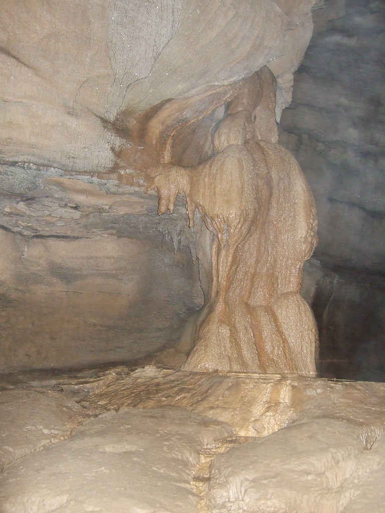

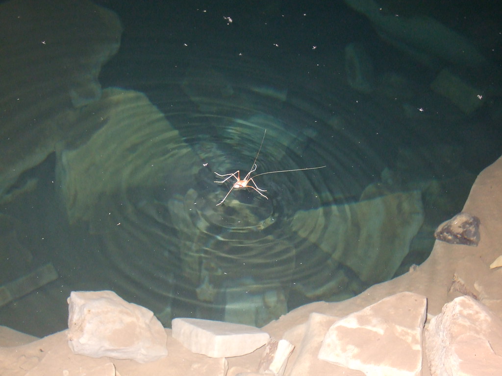

I am a caver and have done quite a bit of cave photography although I don't carry my dslr caving. I have a cheap P&S that does pretty well. The lighting will tend to be really yellow and not as bright as you think. Most show caves will not permit you to carry a tripod but you might get away with a monopod. Most things that you'll be seeing will be within range of a flash. There will be a lot of wet surfaces so you will get reflections from the flash. There will also be a lot of water vapor and you will find that some of your pictures are nothing but something dimly seen through the fog. Stop breathing for a few moments before pressing the shutter. It does help since a lot of the fog you see will be from your own breath. Here are a couple of samples taken with a Fujifilm F20. Not my best but all I have on flickr at the moment. (These were in a "wild" cave and completely unlit)
