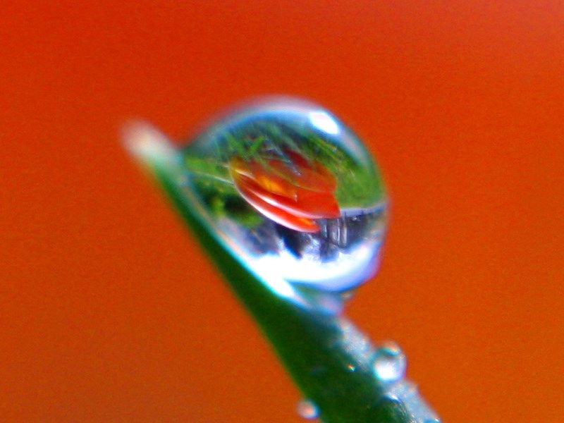

I was playing around with this last week and got some interesting results. I wasn't really aiming for getting that "small world inside a water drop" shot, I kind of just happened. ;)
I used a vintage Pentax 55mm (M42 mount) with 50mm (or so) extension tubes on a Canon 1000D. Macro on a budget! Here is a 100% crop of one of the shots:
The lens is not quite sharp at f/1.8, so this is shot at f/4 (1/500 sec, handheld). I placed a tulip behind the straw and it shows up clearly inside the water drop. I took a few more shots also, you can read more about it here if you are interested (I hope a little shameless self-promotion is alright):

I have extension tubes, I have been trying different variations with my 50mm prime, I am following exactly what is being told, but I just can't seem to get proper focus inside the droplet due to curvature. There is a lot of Arberation and distortion, I can not get the nice, smooth, uniform focus as seen from others.
Do optical physics behave differently in Canada? Because I have no idea what I am doing wrong.
HA! Finally.
It was my aperture. Needed it closed tight. Seemed obvious enough once I thought about it. Did not think it would apply to a refractive curved surface.
