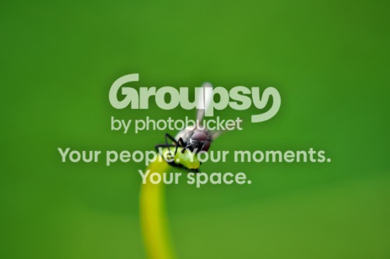

Little guy posed (asleep?) for about 15 mins in the swaying wind. He was only about 1/8 or 1/16 of an inch long. The +10 macro lens gives an extremely tiny focal range, so this was super hard to take. This was the best one.
Tell me what you think.
Thanks.
Mark
looks like you got the focus right on the tip of his nose and eyes! But whilst the background has blured wonderfuly I think you really need to stop down more- get to f8 at least and if you can go smaller that would really help - f13 is where I do most of my macro work. Otherwise you depth of field is razor thin - it makes it a lot harder to compose a shot
For some reason, with the macro on, the aperture is fixed like that, or else I would. Thanks

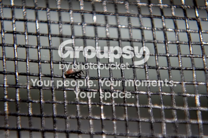

This flying insect was on my window screen (again, regular fine mesh screen), and was also about 1/16-1/8 of an inch in size, look at the depth of field in this one.
This was shot at F/8 and the DOF is still this tiny, im guessing less than a quarter inch. You can see, even the back half of this tiny insect is out of focus. This is how all the photos turn out with this attatchment on.
Unless the surface is flat all the way across, only this much will be in focus, that is why I am so happy about the 'rest' photo, I had to fight the wind as he was on a 5' waving stem of a grape vine with this small of a DOF to work with.

ahh so you can use smaller apertures but the depth of field remains small for all of them - that makes far more sense - welcome to the world of macro :) Even though it is small still keep to the smaller apertures - it does help to get every tiny bit you can!

Thanks. I didnt post it because I thought everyone would say it was too centered. Crops dont reaqlly work with this one, I dont think. To give you a better example, this photo was taken at F/13 and still less than 1/16 of an inch is in focus (barely at that..)
And so little is still in focus, so I dont think it really matters with this attatchment, but I still keep it with a high a number as possible with the lighting conditions.

i looked at a few of your macro posts elsewhere and by far like the first one here best.
good job!
I love the feeling of the first one and I think the centering composition works with this. Thanks everyone.
