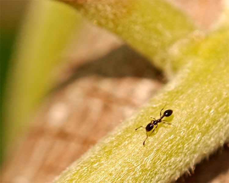

Sorry I didn't get into this thread a little sooner, I see big mike has everything in order. :) Been out of the loop for the past couple of days with my "honey-do" list. Keith, obviously there is no reason a reversed or doubled-reversed lens can't be as sharp or sharper than a standard macro lens. For best sharpness, use 2 prime lenses when using the double lens technique. All zooms give up at least a little to primes, especially in macro applications. Remember DOF goes down as magnification goes up. For max. sharpness try to keep your subject parallel to the film/sensor plane. This might seen like a quick way to a boring pic, but in the macro world, as much of the frame in focus makes for more interesting images.
I think the sharpest reversed-combo I ever shot was a Nikkor 50mm 1.4 with a another Nikkor 50 f/2.0 reversed. That was a great combo. Very sharp and great contrast.
