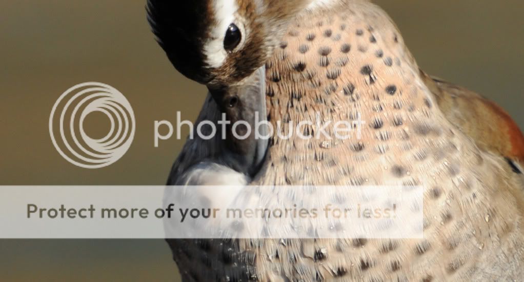

First photo
Ringed Teal (Captive-Escapee), England / Distance 12 m
Camera - D3s
EXIF DATA
Aperture f/8
ISO 1000
Shutter Speed 1/1250
100% Crop
As you can see the image isn't as sharp as the 600mm alone, but its off use-able quality.

It's not as sharp as my 300F2.8 with a 2x fitted
Thanks for doing that buddy! Any chance of some 100% crops to really see the detail that is lost?
Done for you buddy.
Not really a fair comparison, there's a lot more atmosphere between lens and subject at 1200mm then 600mm.
The 600mm f4 is definitely sharper, and a stop faster then a 300 2.8 with a 2x tc.
Out of interest are those processed (ie sharpened for output not just RAW sharpening) 100% crops or unprocessed (ie only basic RAW processing and no clarity, contrast boost and additional sharpening)?
Completely unprocessed, straight out of camera. You can see the final results in my flickr
That's it - just for you - I've now got to save and get the 300mm f2.8 M2! ;)
Seriously though for unedited shots the image quality looks perfectly usable to my eye - a bit of sharpening and for most uses it should be totally fine. Granted its not the most easy of combos to use and good weather is going to be key to getting a good result (not just good light but a low haze as well), but for 1200mm its good.
