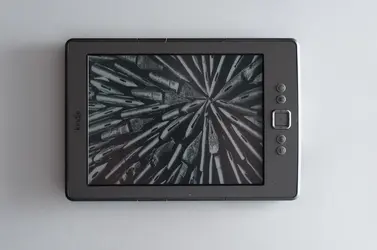

2) Reflecting surfaces. If you have a reflecting surface right in front of you, perpendicular to the direction you're shooting and very close to the camera, you'll see the built-in flash. See this picture:
However, you can solve this problem by putting something in front of the built-in flash. The "something" can be a proper Nikon accessory (SG-31R IR Panel for Built-In Flash from Nikon) or a piece of paper stuck between the body and flash, which is how I shot this:
