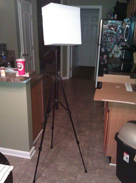

Sure....it was just a large USPS PRiority Mail box, available for free in the lobby at any post office. Grab a "Large" size and a "Slim Box" w the adhesive strip on it... I opened he box (it is white on the outside) and retaped it so the white was INSIDE....
Mounted on Tripod ... looks pretty legit lol
softbox by cminusphotos, on Flickr

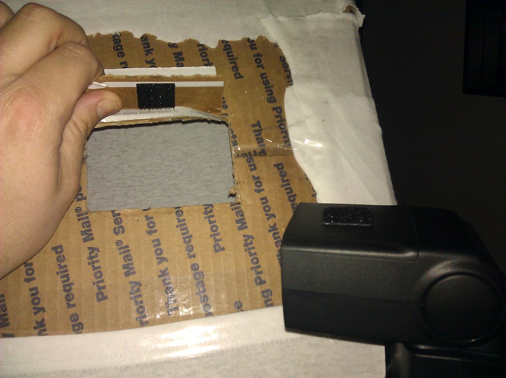

Flap
Velcro mounting flap by cminusphotos, on Flickr

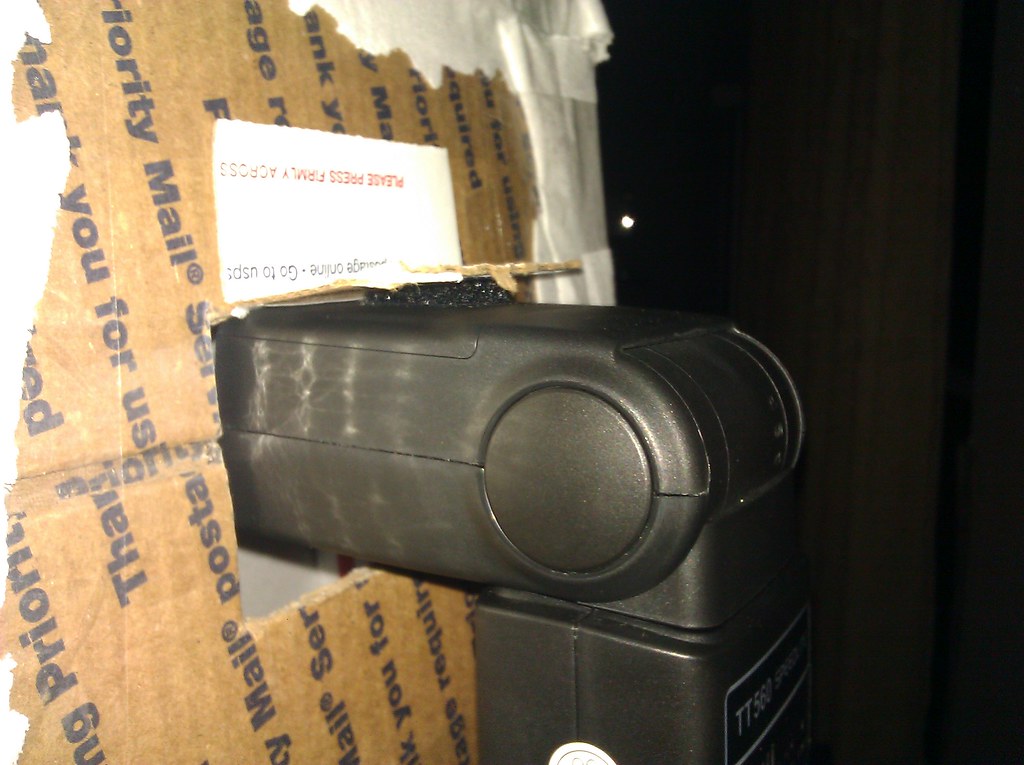

Attached (could def do better here, but I didnt measure at ALL lol...
Attached by cminusphotos, on Flickr

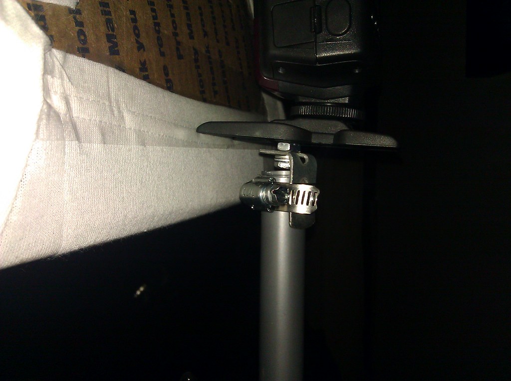

My Ikea lamp broke, it is now a makeshift tripod!
Sweet mounting bracket on broken ikea lamp by cminusphotos, on Flickr

Your DIY softbox has worked very well, your eyes have come up nicely! One suggestion if I may - a reflector
on the opposite side to the light would fill in the shadows just a little bit. Worth a try anyway. And by reflector,
I mean a white panel or bed sheet or large piece of paper or even a light coloured wall.
I'm going to try a large whitte posterboard, I thought the same thing as well!
