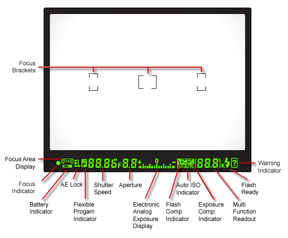

As far as I know, that focus indicator is on all Nikon DSLR cameras (including my 10 yeas old Fujifilm S2 Pro)... but I could be wrong... lol
For your D40x, here's an image that may help. The little green dot on the bottom left is the focus indicator that I'm referring too, sorry for the confusion. That has to stay green while you're pressing the shutter.
