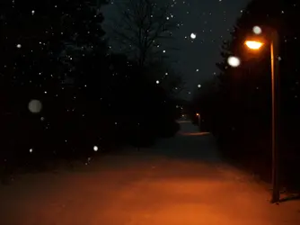

Hey, guys. I was walking around one evening not too long ago and I saw an opportunity for a photo. I changed the mode of my camera to `Snow` in order to optimize the colour and texture of the snow, but I forgot that the flash always switches on when I change the mode. I took some pictures and after reviewing, I realized that using flash while snow is falling catches the snowflakes in a somewhat bokeh state.
Anyway, I am pretty satisfied with these snapshots so I wanted to see what you guys think. Do you have any advice for me? How could I have improved the quality of this image? Is there any technique I could have used to improve anything?
Now, I am still beginning here, so I do know that these snapshots are nowhere near `awesome` status, I'm simply doing what I can to get criticism.
Photo:

Put your camera on a tripod, go to manual exposure/ISO and turn the danged flash off. You will end up with a long exposure and will not see the snowflakes falling, but you will get nice sharp details in the lightpost with the snow better exposed. Also, experiment with the white balance setting,start with incandescent and move through tungsten, at a minimum set it to shady and have a consistent result to work on from image to image.
I disagree somewhat...If I wanted to take a snapshot of the snow falling at night I'd want to see the snow. To capture it you'd have to use flash, otherwise you wouldn't see it or it would look like rain falling.

Hey, Tony S, thanks for the suggestion. I actually took one more without flash because I know how it is forbidden in the photography world. It doesn't look much greater than the two with snowflakes, and in my opinion it looks much more boring because there are no snowflakes visible, but everything is a little brighter. I've been considering buying a tripod, however it would most likely only be used for still-life shoots, as I tend to just whip out my camera when I see an opportunity and carrying a tripod around everywhere without a planned shot is a tad awkward. However, I at least make sure that I'm actually trying to take a photograph, not just a snapshot. Eventually, once I've developed some decent skills and understandings, I want to invest in a Nikon D5100, how does that sound?

Here's the photo without the snow, feel free to give advice on this one as well.
The light is a bit too shiny, I think... But I do like the orange colour it gives the scene :)

What is forbidden? Flash? If that is what you meant no it's not forbidden, but if you are going to use it then it needs to be done right.
If your intent is to show falling snow, then you would need flash to do it, but you need to know how to set it. Find the exposure for the scene you want to catch, have the flash pointed so it only lights the falling snow (not the bushes in front of you), and then a key important part is to use second curtain sync so any motion/blurring of the snow flake looks like it has a natural downward movement, not an upside down one. It also would help to have the flash off the camera so you don't get reflections from the snow crystals bouncing right back at the camera giving ghost like images. It's tricky because you want to balance the ambient light on the snow on the ground but light the falling snow enough with flash to stop it's movement.
Edit added: I don't think your EasyShare will do the second curtain sync.
Yeah, considering the EasyShare doesn't even have a manual mode, I don't think it will be capable of the second curtain sync either... I'm actually taking two classes right now that involve photography, so I'll post my projects on TPF for C&C as well, and hopefully we'll start to see some improvement!
