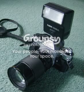

here's a picture of the camera and lens (it's a zoom lens);

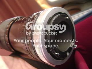

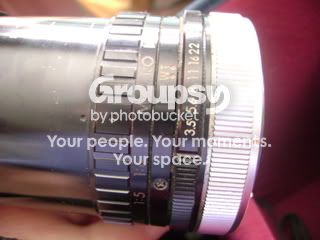

here's the bottom of the lens with the f-stop wheel... I can move it all I want, it's not stuck, but I never see the aperture diaphragm move;
another of the lens (under the f-stop wheel there is just black space -- nowhere for an aperture curtain);

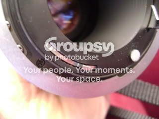

here's the lever that moves when I move the wheel, no problem there;

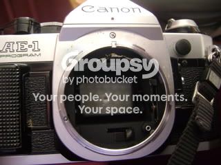

here's the camera;

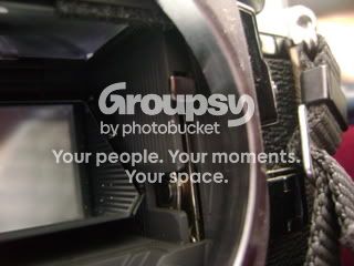

and here's where the lever in inserted to;

Itsa Breach lock mount...
The lens operates a full wide aperture for easy focusing. There is a lever that moves and "tells" the body the current aperture the lens is set. The aperture diaphragm will close and reopen automatically on shutter trip.

btw.. I see in the picture that the camera includes that removable plastic grip thingy. DON"T LOOSE it... in many cases that one bit of plastic is worth more than the camera. So many people loose them over the years and they are forever looking for a replacement. I took it off and kept it when I sold one of my AE-1s a few years ago.

My problem is that when I took the lens off and adjusted the f-stops, I couldn't see the hole widen or become smaller. When I look through the lens and adjust the f-stops, it looks like it just stays on the maximum aperture. Is it supposed to be like that??
