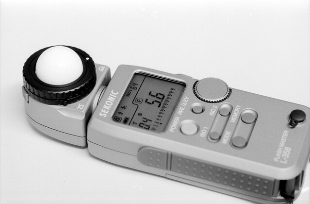

If this were not the case, hand-held light meters would not work.
So now its that time again to create a thread and ask what hand-held light meters are. :popcorn:

They do make life easy... Especially with flash.
The meter in your camera is measuring the light being reflected by the subject. That ^^^ measures the light falling on the subject. It can also measure reflected light with an accessory that I do not have (it replaces that white dome).
edit
Actually, I do have the reflected light attachment, but there is *another* attachment (a few of them, actually - 5, 10, and 15 degrees, I think) for spot metering reflected light - I don't have *that*.

Now the hand held light meter is kinda the same thing except much better. Then you make adjustments on your camera to what the light meter states.

HAHA! They're still pretty useful in the digital age.
Do you have to use it with a flash? How about building? Does it work on that?
You don't "have" to, but it lets you get everything dialed in right much quicker.
The next best thing (for getting it right the first time) to using a flash meter would be calculating the proper settings using the Guide Number of the flash. For that you need to be at reasonably good at estimating distances though - many people aren't (in my experience, that's the part people have the most trouble with - accurate distance estimation. I measure stuff every day though, so I'd say I'm pretty good at it, lol.). And being able to do simple math in your head quickly would help too. (Most modern flash units have this built in though, so all you really need to know is how to estimate distance.)
What a lot of people do is just guess, check the LCD, change some settings, check the LCD again, etc...
edit
Not sure what you mean by building? Taking pictures of a building? Sure, it would work for that. If you're metering the incident light (using the white dome thing) the meter will need to be in the same light as the subject though.
