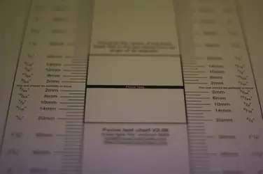

I did manage to take some pics of a book outside in full day light but the pics came out pretty clear. The only thing that I don't like is that there is a soft glow around bright spots. Is this just a characteristic of the lens? I didn't include those shots, but I can if anyone is interested in seeing what I'm talking about. I did however, print off a focus chart and do a test in my office with a light pointed right at the chart. both pics are shot at ISO 100, with the aperture wide open. The Sigma was at 70mm, and the 50 is a prime... It looks like the sigma is focusing a bit past the center and the fifty seems to be just a bit in front of the center line. Also, whats up with the purple and green tones in the fifty pic?
