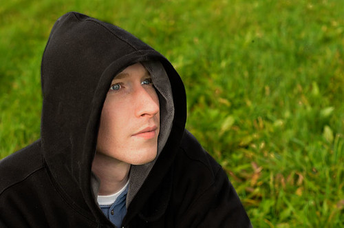

I watched a tutorial about skin tone by the numbers - how Cyan should be about 1/3 of Magenta and yellow should be slightly higher then magenta. Everytime I try following this the skin tone comes out looking wrong to me. My monitor isn't calibrated so maybe its just me but here is an example. The person in the photo is the one whose skin tone I have the hardest time with since he is a red head. His skin looks really orange red to me. How would I fix this? I tried curves and hue adjustment but I can't get it right. I'm also not that great in photoshop so any advice will be greatly appreciated!
Does this photo look too sharp?
Can you post the image as it came out of the camera, with no editing at all?

It looks very fake.

JPEG from camera

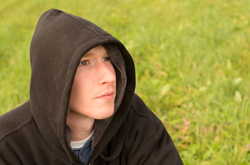

This is from Camera Raw - I didn't change any of the settings - I left it the way camera raw rendered it
You have two different lights hitting the face so it will be a little tough to even out.

The red channel is very hot; most of the skin details are gone from that. So I first duplicated the background layer, copied the green channel and pasted that into the red channel, and changed blend mode of that layer to luminosity. That restores some detail to the skin.
After that, I selected just the face and used a curves adjustment layer to tweak that. Then selected the background and used a selective color adjustment layer to tone that way down. Finally, I used the shadows/highlights filter to brighten the face a little.

Thank you so much! I'll have to try that. I never knew you could copy one channel to the other. Do you or have you ever tried to get the skin tone right from the CMY values? I'm just curious because on other photos where the skin color looks right the. CMY values don't match the "formula" or even come close.

Kind of , he was in the shade under the hood and half the face was exposed to sun. Just watch how you pose and where you pose as it creates more work for you in the future. Not everything is fixable in photoshop.

I actually used a custom white balance but ended up fixing the WB in RAW.
The sun was going down so the light was different during this picture and the custom WB didn't work anymore.

I sometimes monitor CMYK values when adjusting skin tones (I did in this case), but I don't come anywhere near to following any formula. In this case the cyan value was 1%, which told me the reds were probably out of the ballpark, so I checked the red channel and found it was mostly clipped.
Chris Orwig has some pretty useful discussion of CMYK for skin tones, in section 3 at this link: Photoshop CS4 Tutorials | Portrait Retouching Essential Training
For me, monitoring CMYK values has been most useful as training in seeing skin tones in those terms. If the color is amiss, I can often just "see" that there's too much magenta or not enough yellow or whatever.
