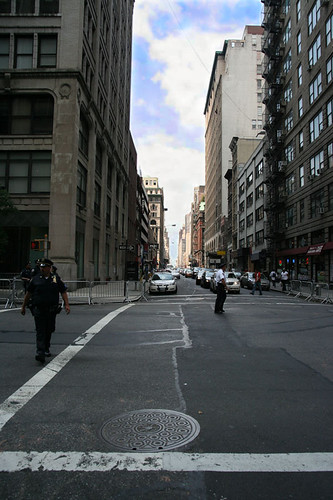

hey guys, i went to NYC and did some random shooting to see what i could get. i have a sigma 17-70 and a hoya CP. there were lots of clouds in the sky but plenty of blue as well.
most of my picture(s) was buildings and about 1/3 was sky, and no matter where the polarizer was positioned, the sky was blown out! i couldn't figure out what i was doing wrong =[
do i need to add a 4 stop grad ND filter too?
ill post an example if you need it

It would be helpful if you would post examples that include EXIF data, but the other replies have pointed out the main points: use ND grad filters and bracketing when necessary.
And taking pics of buildings and a skyline is going to be hard to do with a grad ND because they are in a straight line. Exposing in between or for the sky is worth a try. Otherwise you'll have to do some serious postprocessing. Overlaying properly exposed sky and porperly exposed building photos. Circular polarizers in my experience are not the most effective during midday either.
Derrick
That one looks tough to bring out the sky even with a graduated ND. My suggestion would be to slightly underexpose your photo to try to get a little more detail in the sky, yet that might turn the people in your photos to complete shadows. Then when post processing, make 2 copies of your original. Leave the original on the bottom and untouched. 1st copy use to adjust exposure. 2nd copy use to adjust the sky; perhaps some saturation, color balance, D&B, etc. then layer mask the sky into your 1st copy.
That's just my 2bit suggestion. You might be able to get away with doing that to the photo you provided. Maybe I'll give it a go when I get off work. G'luck :)
