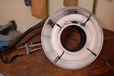

Okay... this is a clamp light, round flourecent (sp) light (this one has a built in ballast that screws into a light socket), a 4" pvc plumbing coupler and some rewiring. I set the pvc coupler on the clamp light and cut the hole larger with a dremmel tool then screwed it in shaped it and sanded it. I then rewired the bulb (I had to cut the ballast housing to get it to fit, lengthen the wires and then I cable tied the light in place after I drilled holes into the metal housing.
attachment.php
I used 2 small "L" brackets to attach the original handle on the light and then I painted the back a flat black. I did use grommets and a wire harness cover to protect the wire. Then I screwed in the ballast to the original clamp light socket, plugged it in and prayed that it wouldn't shock me when I picked it up!
30 bucks. Alien Bee - $400.00 (but I am going to order it this weekend. I need it to fire the other strobes)!
