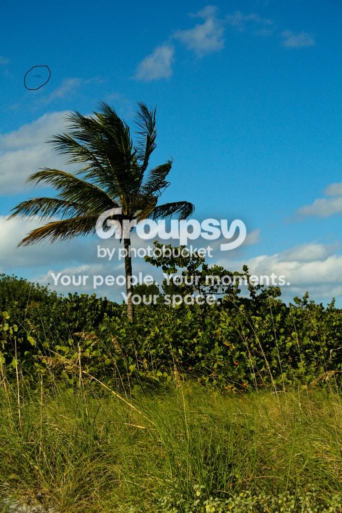

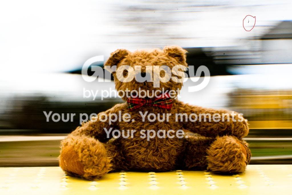

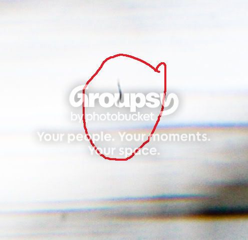

It looks like a hair or fuzz or something... I took some shots at the park last week... I'll post some pics a bit later so you can see what I'm talking about. Right now I have to get to the camera store before they close for the holiday. :)
Oh it was definitely there before I took it in. That's actually the reason I took it in. I kept cleaning everything I personally knew to clean... and it wouldn't come off. :(
Ok, here are a few shots. It's not always a big deal because I can sometimes edit it out. But, I'm not the world's best editor and not all situations are conducive to doing so (at least for this newb :lmao:)... I'd ideally just like to get this off my sensor.
That's just dirt. Check out the products from Visible Dust, or search these forums for those words and "sensor clean". I had a number of posts, so put my name in, too.
