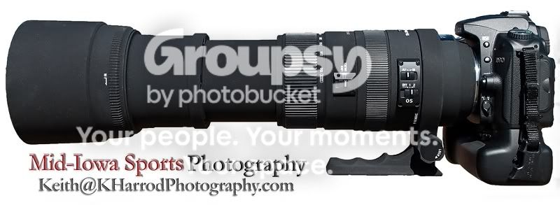

Before I got the Nikon AF-S 200-400 f/4, I was using a Sigma 150-500mm f/5-6.3 AF APO DG OS HSM Telephoto Zoom Lens for Nikon Digital SLR Cameras
I used aperture priority set to the widest aperture any variable zoom lens had, auto ISO, and I kept a really close eye in the viewfinder on the shutter speed the camera was selecting. I wanted 1/500 and above most of the time. If I could antisipate and catch the peak of the action 1/250 usually worked OK. Continuous back button focus spot metering were other choices I made.

Here's the Sigma 150-500 (zoomed out to 500 mm) on one of my gripped D90's.
