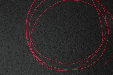

The more I think about it, the more I am convinced you could in fact get a spiral just like that by hooking your zoom up to a cine motor and gradually zooming out over the entire exposure period.
However, this would be an awful lot of effort, and exposure equality would be an issue (you'd need to heavily rectangularly anti-vignette to make the outer stars as bright, since they weren't in the frame at the start). Also, it would be impossible with the windmill in the frame. You would have to get a clear shot of the sky somewhere else (perhaps just 100 yards to the side), and then photoshop it in as the bacgkround behind the windmill, so it requires very significant photoshopping anyway, why not just do it all in photoshop?
I have seen photos where people zoom out slowly over a long exposure of the stars and it looks nothing like that. more like the scene in star wars where they go at warp speed
Warp speed would be if you zoom out over the course of a 4 second exposure or something. If you zoom out over an hour exposure, you can't get straight lines. The zoom is straight, but the stars are spinning = spiral.
Here, I just went into my bedroom and confirmed it using a zoom lens and a laser pointer that I spun in a circle on the ceiling.
One is without zoom, the other is with. Same circular motion in both cases. Not the best quality test, but I think the results are still pretty obvious.
Notice the things that stay relatively still during the exposure -- the popcorn ceiling texture -- look like warp speed. But the thing that was noticeably spinning becomes a spiral. So if you zoom out in a fast enough exposure that you wouldn't normally see star trails, you'll get warp speed. if you do it over a period of time when you normally would get huge star trails = spiral. You can adjust how spiraly the spiral is by choosing in between shutter speeds.
