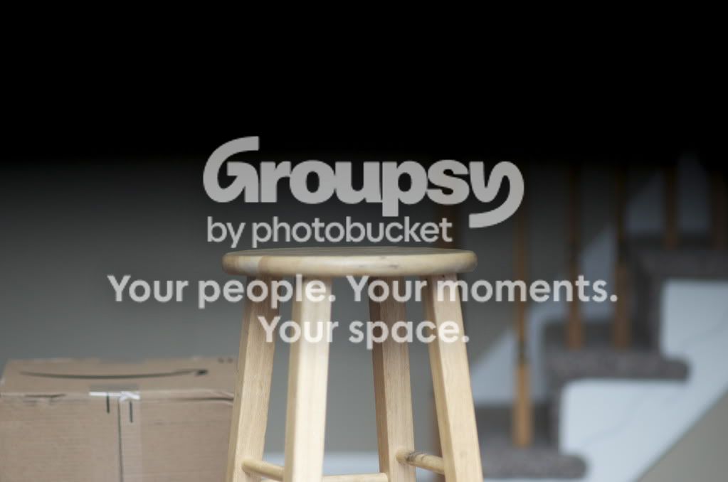

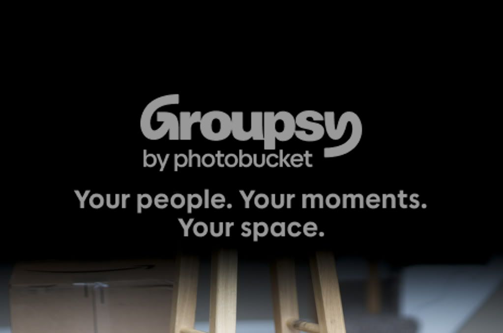

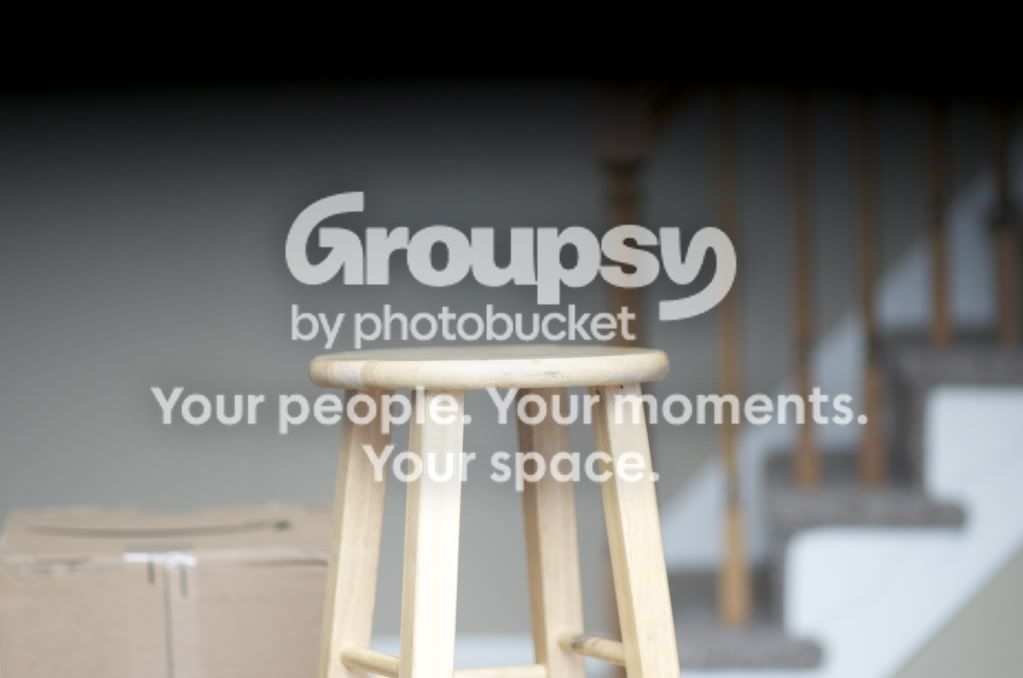

I was able to borrow some lighting equipment for the weekend as an introduction to strobist work. FYI this is my first time, and I don't have a manual. I am using a pocket wizard and SB-900. I am much more familiar with the SB-600 which I have, but I cannot use the pocket wizard with it. Anyways back to my issue, I feel like there is a delay. The light is too slow for my shutter speed....please help.. Take a look at the pictures below
Too fast of a shutter speed for syncing with the flash.
Exif says your slowest shutter speed was 1/400.. the others were 1/500 and 1/800.
Try something like 1/160, or 1/200.

Your shutter is too high or fast so you see a portion of the shutter curtain going through all three frames. Your camera has a max speed sync. Not sure what it is but I'll bet its in your manual. And you can use triggers with an SB600. I do with mine, not sure why pocket wizards wouldn't work if they cheap ones do.
Your shooting a stool!!!!!!!....why is your shutter speed so high???????.....keep it in your camera's sync range.

The new Flex PW to another Flex PW can do HSS. Most of the time you are OCF you will not go above 200 Anyway. Your 300s should go to 320 Though.

Since your using a flash there is no need for such a high shutter speed anyway. Like someone else suggested, slow down to 250 or below on the shutter. Since you have a D300 (from what others have said, can't download exif at work). You can use your SB-600 and SB-900 off camera wirelessly, using Nikons (D300's) system. And it works just fine. I do it all the time (d300, 3-sb-600's, sb-900).

Check out your flash sync speed on the d300 'flash' settings menu. Set it to 250*.
