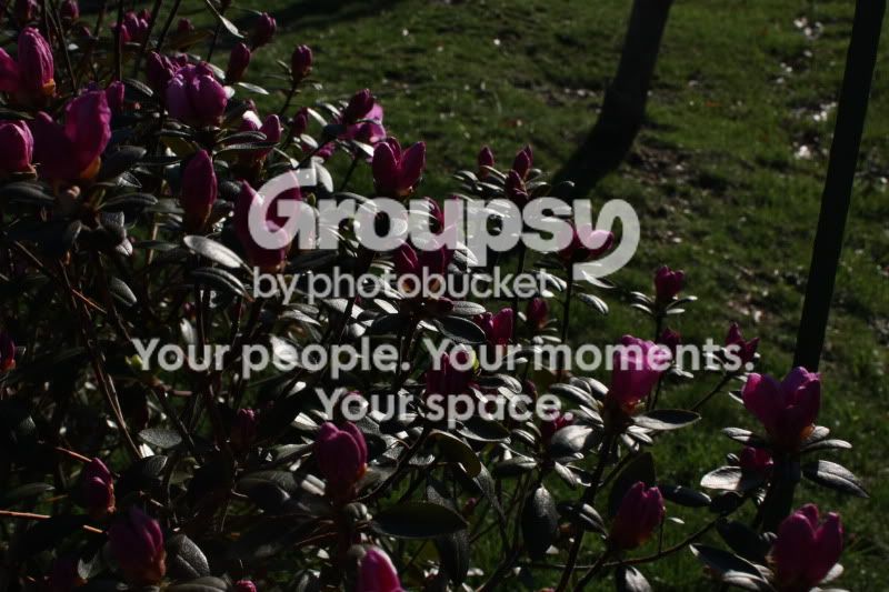

I found one that I used the sunny 16 rule for and didn't delete...
That is unedited... ISO and shutter speed at 100 and f/16...
