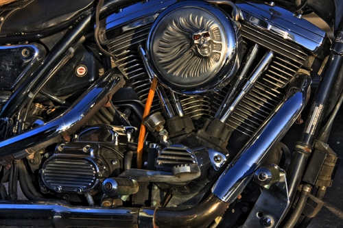

here is my entry :)
I didn't do much "refining" if you will. But this is the general gist of what I would have processed.
Very interesting! What application did you use? Did you cheat the exposures any? I'm guessing this is Photomatix, or at least not PS.
And thanks for playing! Great way to start the new year IMO :thumbup:
-Shea :mrgreen:
Capture One is the RAW workflow:
1. custom WB
2. tweaked exposure and contrast
3. tweaked the shadows and highlights
4. sharpening (180,0.8,1.0)
5. noise reduction (luminance 25, color 37)
6. output to a 300 px/in jpg
Photomatix:
Generate HDR image using batch processing
Tone mapping: strength 100, color sat 95, light smoothing 0, luminosity 10, micro contrast +2, micro smoothing 0, white clip @ 2.290%, black clip @ 5.000%
saved as a jpeg and opened in Photoshop
I can't remember the exact details in PS b/c i didn't save as a photoshop document which saved all my actions...so im going from memory.
Photoshop:
Unsharp mask
bumped down the cyan/blue saturation to remove a blue cast on the metal and increased the lightness
levels
contrast
noise reduction (can't remember if i did this or not, i think i did but it really didn't look any different) I don't have any plugin for noise reduction like Noise Ninja, which i need to buy
Probably took around 10 to 15 minutes. If it was my own image i might have spent more like an hour getting things the way I liked, using layer masks and such to maybe bring out some better detail.
I think was the general outline

I don't have Photoshop, so this is straight out of Photomatix (also I used the small files because I didn't want to download Canon's RAW software):
Also cool, I like those deep blues. Pretty good results from JPGz. So I may have to D-load that software if I'm going to do much of these. Tnx for playin playaa.
-Shea :mrgreen:
I would of never thought that shot would look so good in HDR but it does. Looks great.
