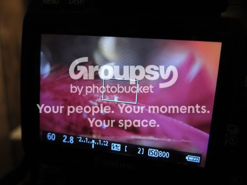

Okay. Sorry, getting very frustrated with the lens so maybe I'm not being that clear :) Pictures are the best way to explain what is going on, I think.
This is in AV mode with shutter speed 60, f/2.8, 800 ISO. And the picture I take looks just like the image that I see here.

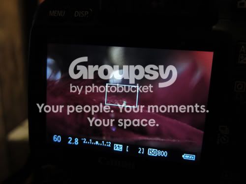

This is on Manual mode with shutter speed 60, f2.8, 800 ISO. The picture that I take looks like the one above. But the image displayed on the LCD is very dark. To get it to display on the LCD like the one above, I have to make the shutter speed 25. But the actual picture I take is extremely bright, and looks nothing like what I see on the LCD.
This ONLY happens in Manual Mode. Every other mode, what I see is what I get. It's why I'm so frustrated.
The suggestions that the problem is that my camera cannot display the exposure in Live View mode do not seem correct because it does it just fine in all other modes. It is only in manual mode, that the LCD display is much darker than it should be. I do not even know if it is exposure settings or not.
Even if I up the brightness of the LCD it does not really solve the issue. Everything looks brighter then. While it does allow me to see the darker display better, the pictures taken are still lighter than what I saw, and having the lcd brightness up all the way makes everything look over exposed when it's not, and really isn't a fix to the problem.
For some reason, turning on Auto ISO in Manual mode seems to correct the issue to some extent. The image that I see on the LCD is the same as the picture that I get. However, it chooses really bizarre ISOs that is causing very grainy images. In the pictures above, if I put it in auto iso while in manual with all of the same settings, it will bump the iso up to 3700 which is a ridiculous amount for the lighting I have in here, and it is obviously not needed, 800 iso is fine. With the ISO on Auto, the image that I see on the LCD is how the picture turns out. Another weird thing about this is that if I manually set the ISO to 3700, it will go back to showing me an image that is darker than the actual picture that it takes. It makes no sense to me!! It's hard to explain, because I'm so confused myself. I'm starting to really thing the lens is defective in that it can't operate correctly in full manual mode, but all things that I read about this lens, I never read about that being an issue with the T2I.
