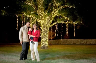

Well this is the best shot out of the group. Wife loves it but I'm not really happy with it. Couple of my gripes
1. The shadow on the grass. - I attempted to clone it out through elements and just wasn't happy with the results.(skill level i'm sure)
2. I should have gotten more separation from the tree. - even though I was shooting with a 24-70 f2.8 I shot this shot at 24mm focal length. There wasn't enough room to backup for the 70-300 to work(creek behind me).
3. It would be nice to have a remote flash system that wasn't manual. Currently my flash remotes only send a signal I can not adjust flash power from camera transmitter.
4. The lens had trouble focusing in the darkness. I had to focus manually which worked for this set of pics but some others on the ground that would have been nice were blurry because I forgot to refocus DOH!!.
Let me know what you guys think and especially how this could have been improved pre and post.
Here are the specs of the photo
D7100 nikon 24-70 f2.8
24mm focal length
1/40 at f/2.8
Iso 1600
I had two flashes fired remotely
both were on stands at 45 degree angles to the camera
Both were shot through a white umbrella
Both were set at 1/64
Thanks
Turned out great! The kid looks super-happy! Lighting looks professional, the tree and lawn look good too. Very nice!
Derrel i expected more criticism from you come on there has to be something.
As-stated ^^^^^ ^^^^^^^^^^^ ^^^^^^^^^^^^ ^^^^^
How do you guys think I could have not cast the shadow?
Would it have been better to use a silver umbrella over the shoot through? My umbrellas aren't the largest would it have helped to have larger umbrellas?
Lastly i have some paul c buff softboxes and model lamps/strobes (x800s) although I can't bring them on location because they aren't battery powered I've thought of getting adaptors for the soft boxes. Would that have been better then the umbrellas?
