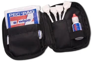

Something like this should work pretty well though: Amazon.com: Digital Survival KIT - Sensor Swab Type 2 (w/Eclipse): Camera & Photo

I've had luck with the solution provided in the sensor cleaning kit. Its a good kit, wish it came with more swabs. I had no problem cleaning my sensor, I used a nice LED flashlight to assist with spotting the debris. I use PEC pads and the pen for my lenses.
Let me summarize:
Is there any cleaning solution you recommend to clean dried drops or other things on the lens that doesn't come off with any of the things mentioned above?
Do you use these two for the lenses?
I usually get away with just the dry pad. Sometimes I'll use my breathe.
